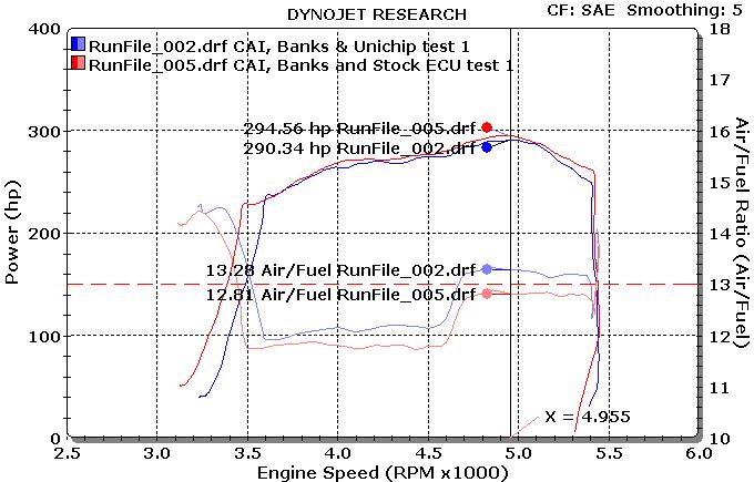

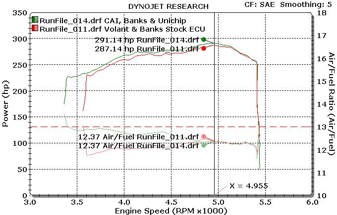

Hey Blazer return it pronto. Did you install it yourself? I hope not Unichip will NOT take it back if you install it. Here's my dynos. More info can be found at Titantalk.com and clubtitan. you can see the Stock ECU beats the Unichip.

There is not a certified Unichip installer in Houston. I installed myself voiding the warranty. The unichip was setup with the stock maps in test 1 above and mods are volant and banks. Test two shows that the CAI exhaust unichip maps installed. Note that in test 1 I ran the Unichip first before stock and in test two I ran stock first and Unichip second. It's clear to me that Unichip maps are non existent just like the power claims. Also the truck tests were done on the same dyno on different days but each test has a stock baseline with Unichip run. If you have tuner in your area you might get lucky and maybe able to make power. If you do then send me PM otherwise your not getting any benefit from the maps or the chip.
out performs the stock ECU but by exactly the sme 4rwhp as proven in test 1.

I also have a unichip and my stock ecu outperformed it on a dyno. The unichip was a custom map for my truck set up for my truck headers, throttle body spacer, exhaust and intake. I'm trying to get my money back!!
