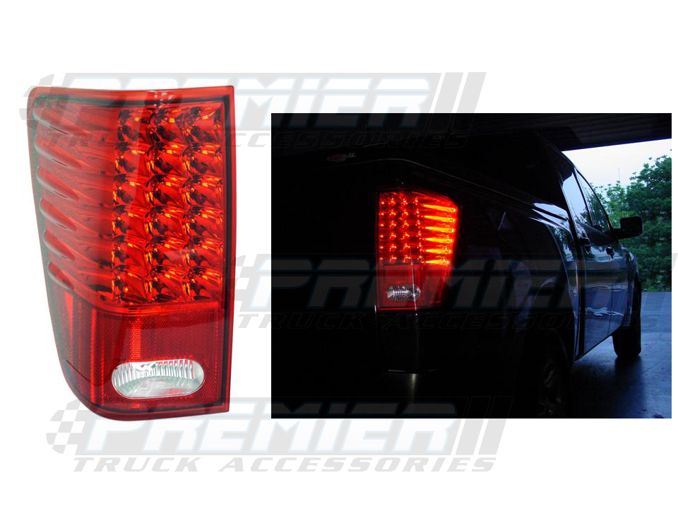

ok, well for anyone that doesnt know, the titan has a warning to show you when you have a turn signal bulb blown out, the remaining bulbs with flash very fast, this is activated when the current draw on that circuit is lessened by a blown bulb, so these LED tail lights draw such a small amount of power, that this high speed flasing warning will be constantly happening, there is a module out there that can be installed to correct this from happening, im not sure myself where it can be bought, maybe sumone else on the forum here can post a link or any info about this module...
