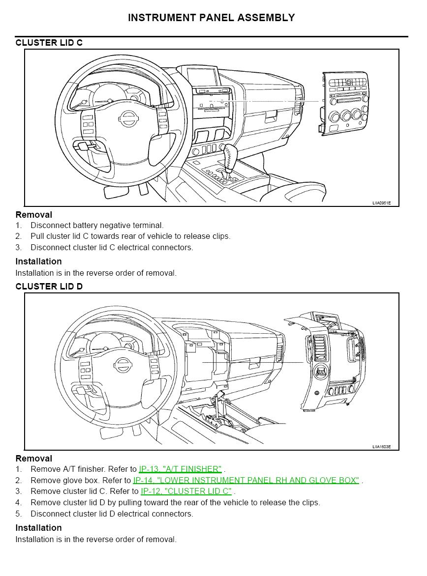

Does anyone know how the center console on the dash (where the GPS would go) is attached? I have my Sirius radio mounted there and it died today. I need to know if that plastic panel just pops off??...If so, I think I should be able to install my new radio in the same place myself and save about $80 in labor. I didn't want to just start prying on it, cuz I thought that the front trim piece that covers the radio and all the controls might need to come off first...Any help would be appreciated....
