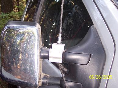

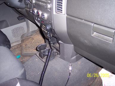

Good for four wheelin' and came in real handy driving from CA to MO and back. Truckers are good about keeping each other informed about cops and traffic.
